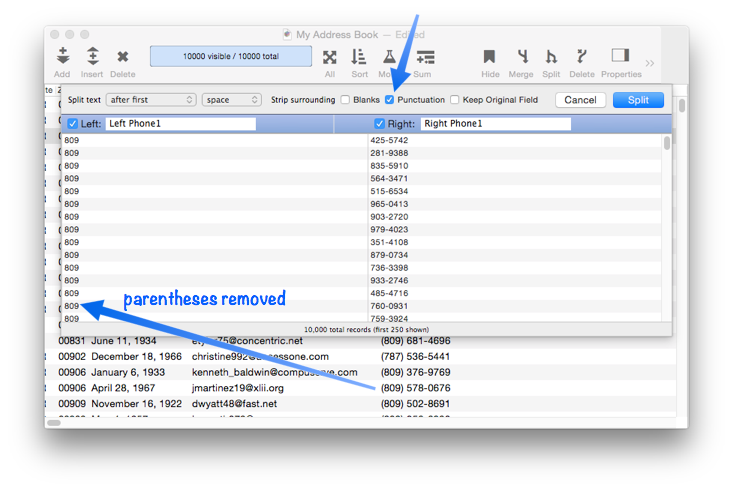

Sometimes you’ll need to strip off punctuation in addition to or instead of blanks. In this example the dialog is splitting a phone number into separate area codes and local numbers. To eliminate the ( and ) around the area code check the Strip Surrounding Punctuation option.
