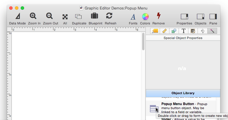

Start by dragging a pop-up menu object from the Object Library to the form. Then enter the name of the field or variable that will be linked to the pop-up menu. Finally, switch to the Formula panel and enter the menu choices, separated by commas (you can optionally include spaces, as shown below). To save time, I preloaded the menu choices into the clipboard.
For a basic pop-up menu, that’s it … you’re done!

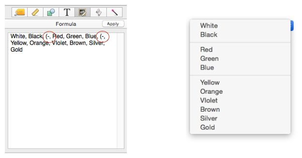

Separator Lines
If you want separator lines in the menu, just use (- in any spot where you want a separator line.

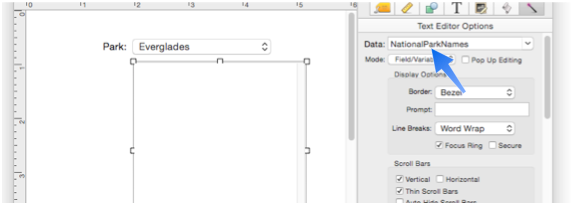

One minor advantage of this mode is that it allows menu choices to contain commas, which isn’t allowed in the Comma Separated Values mode. But the real power of Formula mode is unleashed when you use a variable or field in the formula. Since the variable or field may be changed at any time with a procedure (or even with standard data entry), the pop-up menu can change at any time. For example, suppose you want to make the national park menu user editable. I can create a Text Editor Object linked to a variable named NationalParkNames, like this:
Then I can change the pop-up menu formula to this same variable name.
Now the pop-up menu name can be edited on-the-fly.

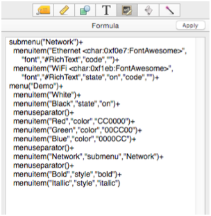

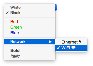

If you want to go the full Monty, you can create a fully custom menu with the menu( and menuitem( functions (see Custom Menus. With these, you have full control over the menu, including styles, colors, images, icons, checkmarks, submenus, etc, like this:
Here is the formula for this menu.
To learn how to design complex menus with these functions, see Custom Menus.

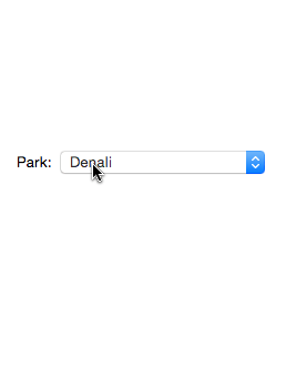

Data – This is the field or variable that is linked to the pop-up menu. You can either type in the name of a field or variable, or you can choose a field name from the pop-up menu (on the right). Panorama will also auto-complete field names as you type.
When you select a choice from a pop-up menu, that choice will be be placed into the linked field or variable. Of course the value of a field or variable can also be set other ways, for example with an assignment statement in a procedure. This code will work with the pop-up menu shown in earlier examples to change the displayed national park to Grand Canyon.
parkName = "Grand Canyon"
showvariables parkName
There is a problem however, if the new value is not one of the available choices in the menu.
parkName = "Petite Canyon"
If the value is not a menu choice, the value will not be displayed. Instead, the pop-up menu will be blank.

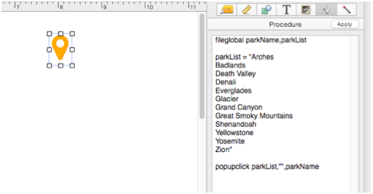

Using the popupclick statement and a few lines of code, Panorama X allows any type of object to be converted into a pop-up menu. In this example, the button was created with the Font Awesome Icons wizard.
When the icon is clicked on, it runs the code which pops up the menu.

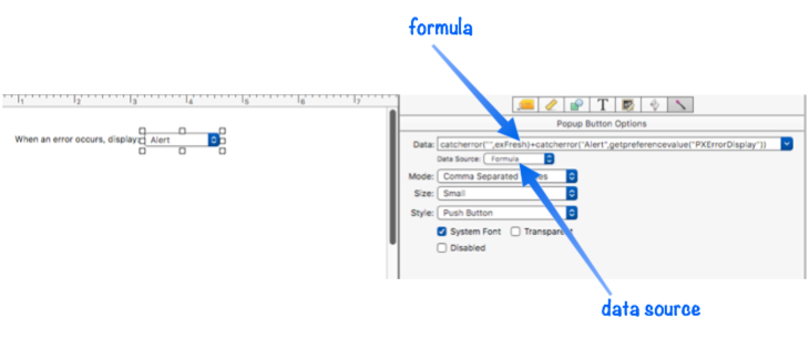

Panorama usually automatically links the pop-up menu to a database field or a variable. The pop-up menu automatically displays the contents of the field or variable in the pop-up menu, and automatically updates the value of the field or variable when a selection is made from the popup menu. In some cases, however, the value may not be in a field or variable. For example, the value might be in a preference value (see getpreferencevalue(), in a file on disk, or might need to be calculated on-the-fly somehow. To do this, change the Data Source to Formula and type in the formula into the Data box. (Note: This formula, which is used for the data value, is separate from the formula described above for creating the menu choices. In other words, a popup menu object can have two different formulas – one for the menu choices, and another for the data value.)
Here is an example that uses the preference value PXErrorDisplay as the data source. (If this preference value hasn’t been set yet, the formula defaults to displaying Alert in the popup menu.)

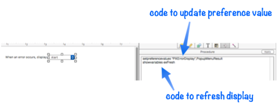

When the user makes a selection with this popup menu, Panorama doesn’t have a field or variable to put the selected value into. So instead, it puts the selected value into a fileglobal variable named PopupMenuResult (if this variable doesn’t already exist, Panorama creates it). It’s up to you to write code that takes this value and stores it somewhere. Here’s code that stores that value into the PXErrorDisplay preference value:
In addition to storing the value, this code needs to make sure that the display of the popup menu is refreshed with the new value. In this example, this is done with the variable exFresh. The second line of the code above tells Panorama to refresh any object that contains this variable. Looking back to the data formula for this object, you’ll notice that it contains this variable inside a catcherror( function.
catcherror("",exFresh)+catcherror("Alert",getpreferencevalue("PXErrorDisplay"))
This variable doesn’t contain anything, in fact it doesn’t even exist! So that part of the formula doesn’t display anything. But even though the variable doesn’t exist, Panorama will still update the display when you use the showvariables statement in your code.
showvariables exFresh
