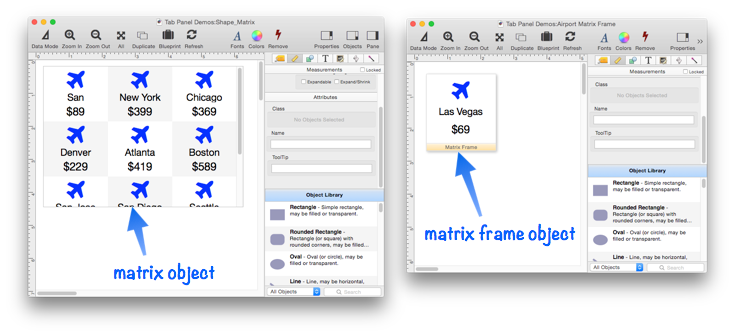

Using a Matrix in a Panel
Earlier on this page it was mentioned that you have to be careful to make sure that the form content will fit inside the panel. But what about a matrix object? In that case, you don’t want the frame object to be inside the panel – you want it to be invisible. In that case, the solution is to put the matrix frame in a separate form.
See Matrix Frame Object to learn how to put the frame on a separate form.
