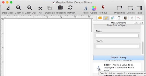

Slider objects allow a numerical value to be displayed and modified with a slider or knob.
Start by dragging a slider button object from the Object Library to the form. Then enter the name of of the field or variable that will be linked to the slider (in this example, myValue). Set the minimum and maximum values, and the slider is ready to use.
