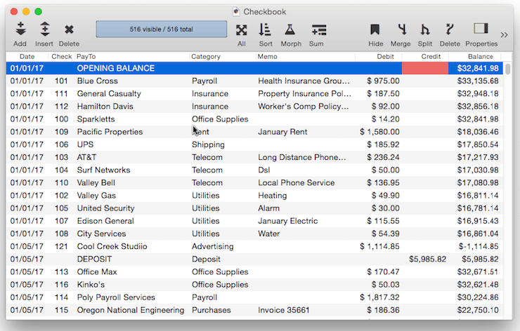

To demonstrate how this can be used, I’ll start by selecting Office Supplies in this checkbook database. I could do this with the Find/Select Dialog but instead I’ll simply right click on an Office Supplies cell, right click and choose Select Same (see Selecting with the Context Menu).
Now I want to revise this selection to show only office supply purchases greater than $500. To do that, I open the Find/Select dialog and set up the selection for checks (Debit) greater than 500. Notice that the preview shows all checks greater than 500, not just office supplies. When you revise selections this way, the preview does not show you what the revised selection will look like.
To actually revise the selection, choose Subset of Current Selection from the pop-up menu and press the Select button. Now the revised selection appears – there are only two checks for office supplies greater than $500.
