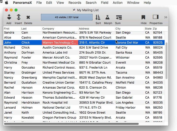

In addition to creating procedures with the recorder, you can also create them from scratch. To demonstrate this, I’ll create a simple procedure that displays a map of the current address. This is easy to do because Panorama has a built-in command to display a map.
Once again, the first step is to use the View menu to create the procedure.
Panorama has hundreds of commands that can be used in a procedure — in fact, it has a complete programming language. You’ll probably never memorize all of the commands that are available – in fact, even the programmers here at ProVUE haven’t memorized them all. Fortunately there’s no need to memorize them – you can simply look them up when needed. To find out how to display a map, simply open the Help wizard and search for map.
I can copy and paste from the Help wizard into my code, or simply drag and drop the sample code from the Help wizard.
Now I simply edit the code with the actual field names from the database.
For this demo, I’m going to make one further change that you wouldn’t normally use. The sample data in this data isn’t real, the street addresses aren’t valid. Since I don’t want to display a map that says location not found, I’ll change change the code to use a blank street address, so that the map will display the city.
Once the code is complete I can press the Run tool or activate the code from the Action menu.
