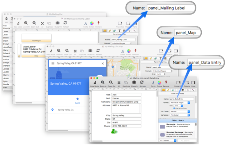

A moment ago I created a form with a searchable list. Now I’ll add a tab panel to this form. I’ll use the data entry and map forms as panels in this tab panel, so my first task is to rename these forms with a common prefix (panel_) so that they can be used in the tab panel.

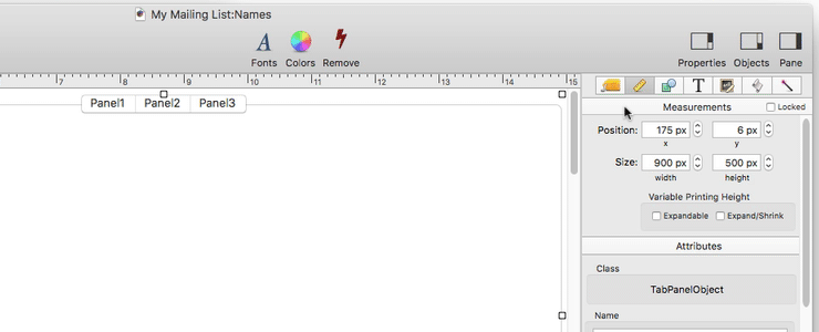

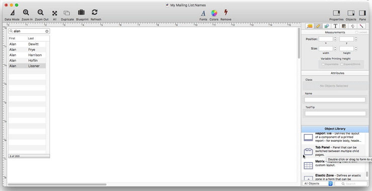

Now I close those forms, open the Names form (created in the previous lesson), then create and position the tab panel object.

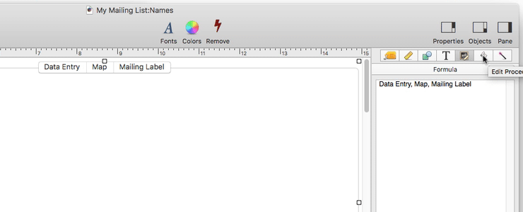

Now I enter the tab panel names into the Formula pane of the object inspector panel. The names are separated by commas. These must be the same names as the forms we just renamed, but without the common prefix.

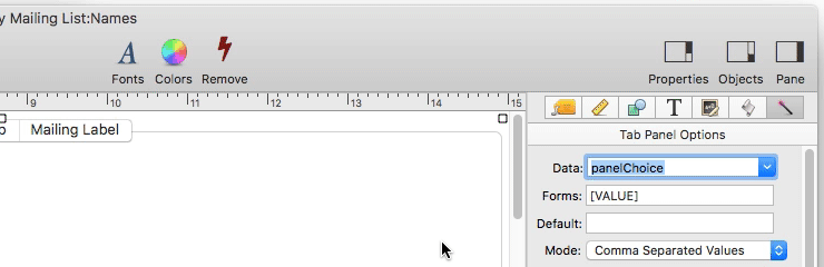

Panorama uses a variable to keep track of which panel is currently selected. It’s up to me to specify the name of this variable, which I do via the Data option in the last pane of the object inspector panel. I’ll call this variable panelChoice. (In this example it’s not really important what the variable name is, as long as it isn’t used anywhere else.)

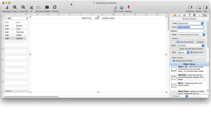

The final step is to specify the forms to be used for the panels. Type in the prefix used when naming the forms (panel_), followed by [VALUE] (which represents the button name).
The tab panel is now ready to use, so I’ll switch to data mode to try it out. I can use the text list to search for a person, then choose whether to display and edit the data, or to view a map.
