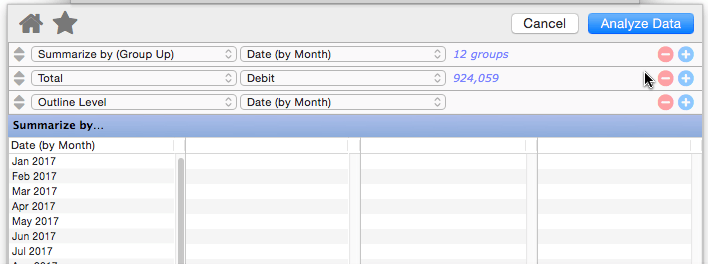

The Summarize & Analyze dialog is a one stop dialog for creating and filling in summary records based on pre-selected criteria. In the dialog you specify how you want the database to be divided into groups, what calculations you want performed, and what level of detail you want to see. Once set up, press one button and all the necessary operations are performed. (You can also perform these operations as separate steps, see Generating Summaries Manually). Here is the basic layout of this dialog.
Single Level Analysis
This dialog looks complicated, but to perform a single level analysis all you have to do is choose the field you want to divide into groups, and the field you want to total. Then simply press the Analyze Data button and all of the Summary Records will be created and filled in for you, and the summary outline collapsed to hide the raw detail and show only the summaries (see Expanding and Collapsing the Summary Outline).

Panorama can create up to seven nested summary levels, for example Categories within Months, or Cities within States within Months within Years. To add an addi- tional summary level, re-open the Summarize & Analyze dialog, then press the + button on the first row to add a second summary level.
Once the row is added, select the field you want to sub-group by.
You’ll also now have the choice of what level of summary to display by default. (Of course you can always expand and collapse the summary outline later, see Expanding and Collapsing the Summary Outline). In this example, the primary summary is by month, with the categories grouped within each month.
Press the Analyze Data button to create the multi-level summary outline.
